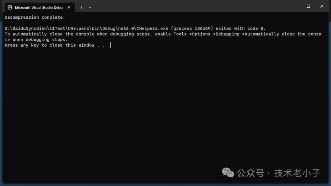

在C#中,我们可以使用System.IO.Compression命名空间下的GZipStream类来进行GZip解压。
static void Main(string[] args){    string compressedFile = "D:\\BaiduSyncdisk\\11Test\\compressed.gz";    string decompressedFile = "D:\\BaiduSyncdisk\\11Test\\测试导入数据1.csv";
   using (FileStream compressedStream = new FileStream(compressedFile, FileMode.Open))    {        using (FileStream decompressedStream = File.Create(decompressedFile))        {            using (GZipStream decompressionStream = new GZipStream(compressedStream, CompressionMode.Decompress))            {                decompressionStream.CopyTo(decompressedStream);            }        }    }
   Console.WriteLine("Decompression complete.");}

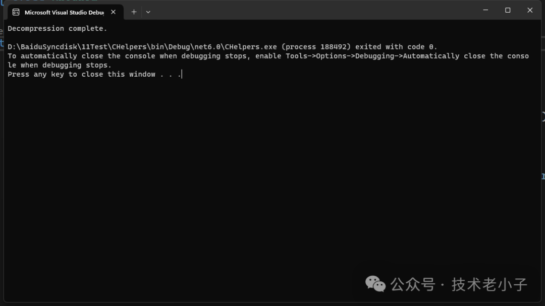

在C#中,我们可以使用System.IO.Compression命名空间下的DeflateStream类来进行Deflate解压。
static void Main(string[] args){    string compressedFile = "D:\\BaiduSyncdisk\\11Test\\compressed.deflate";    string decompressedFile = "D:\\BaiduSyncdisk\\11Test\\测试导入数据2.csv";
   using (FileStream compressedStream = new FileStream(compressedFile, FileMode.Open))    {        using (FileStream decompressedStream = File.Create(decompressedFile))        {            using (DeflateStream decompressionStream = new DeflateStream(compressedStream, CompressionMode.Decompress))            {                decompressionStream.CopyTo(decompressedStream);            }        }    }
